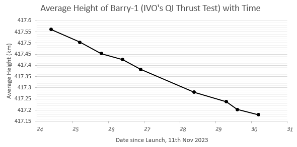

How much would they need just to maintain orbit? Taken from one of Mike McCulloch's tweets:
If it starts maintaining average altitude or rising, that's a pretty strong indication.
Re: EM Drive
I think the chart shows it decelerating at about 10^-6 ms-2, though I'd very much welcome a second opinion.
If that's right a milli-newton should easily correct that acceleration.

Re: EM Drive
Calculating drag was my first thought as well, in fact I think I did it before probably elsewhere here.
Then I realised orbital mechanics should be able to translate height into speed, and we have the decay rate of height from the chart. Hence deceleration.
I started from v^2/r = g ~constant, and differentiate.
That will include all sources of drag.
If it is 10^-6, they have sized the thrusters appropriately.
