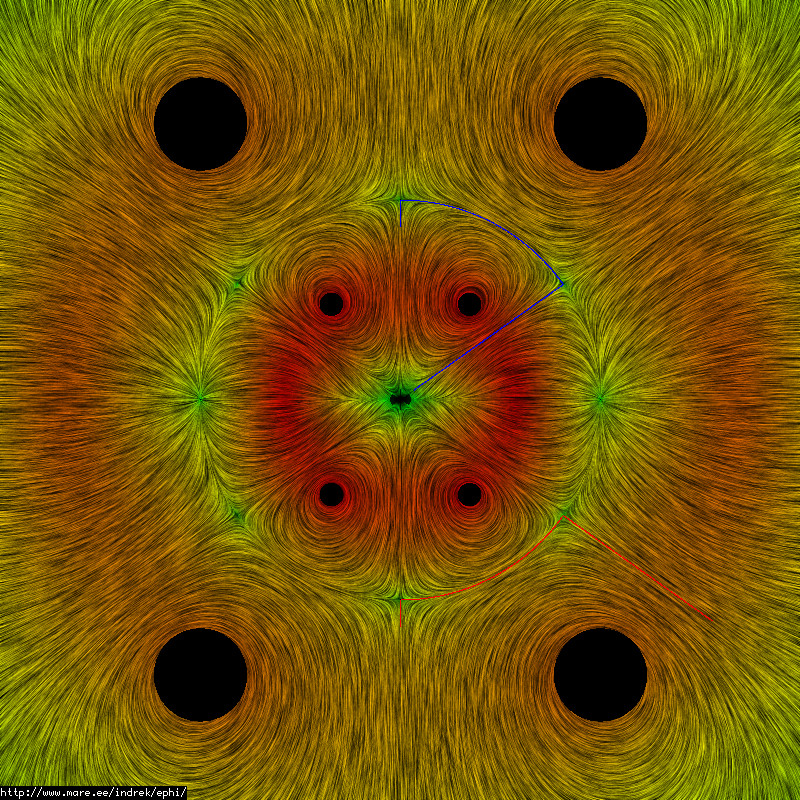

Stealing Indrek's beautiful rendition so ably found by icarus and sketching crudely on it:
the nubs are currently placed right in the middle of the dark blue oblongs which are the quasi-linear cusps that are on, but perpendicular to, the line between the really round cusps. Move the nub up and down a bit (a pair replace the one) and run the proper current thru them and they become the final part of the triangle's coil, and the color below them changes to orange like the main coil. That orange field protects the metal, so no losses, and the nubs can provide all the load carrying capacity you need, without introducing odd torques or moments into the system. At that point, the need for standoffs is minimized. I think we can do just fine with the same number, 4, as the WB6, but I think they should suspend, not support the MaGrid.

icarus wrote:It seems counterintuitive that a field low-point, i.e. the mid-edge cusp, should occur beneath where the coils come closest together, but I think this spherical solution is saying something about the way the field changes when the wiffleball forms and pushes back the magneto-static field.
Actually, I don't think it is a low point per-se, but a point with very low lateral vector. The field is moving mostly into, or out of that sphere at the blue, and mostly tangential at the orange. Tangectial (orange) reflects, radial (blue) transmits. Only where there is a funny cusp (pairs of opposite polarity fields meeting) might there be an actual field null.

Hmm, after looking at the below diagram some more I'm having second thoughts about the contention that nubs directly above mid-edge cusp is bad. The osculating coils, that are not shown in this section since we are looking at the diagonal section that bisects them, are at about a similar radius as the large black coils shown. At that level, the field lines are quite uniformly radial and the slight orange tinge suggests the field is stronger at that level directly above the mid-edge cusps.... more head scratching is in order, I think.
