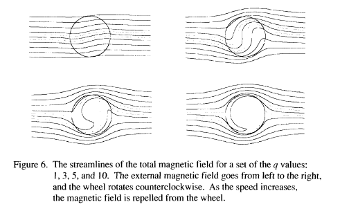

An Experimental Investigation To Determine Interaction Between Rotating Bodies
http://www.ntrs.nasa.gov/archive/nasa/c ... 020760.pdf
7. EXPERIMENTAL RESULTS
A brass (copper+zinc) wheel, with a 4-in diameter and I .4 in thick, was used for this investigation.
Ceramic ball bearings were used to safely spin the wheel up to 40,000 rpm. The wheel was also
electrically insulated from the rest of the armature. For spinning, an air turbine was used. The rotational
velocity was measured by two methods: (1) A simple strobe light and (2) a photodiode that detected
laser beam pulses as they passed through a slot in the rotating shaft. The magnetic sensor is based on a
giant magnetoresistivity, and consists of a balanced bridge circuitry. The position of the sensor was as
close as possible to the rim of the wheel. The linear dimension of the sensor is =8 mm so that the offset
from the surface is on the order of 15 percent. We did not use any goniometer system, so the accuracy of
the angular position is not high, being estimated within a few degrees, with the main uncertainty being
the direction of Earth's magnetic field. We attempted to fit the experimental data with the presented
theory by selecting the best value for the electrical conductivity of the wheel. The results of this procedure
are displayed in figure 11, where the black dots represent experimental values. A slight misfit on
the right shoulder can be due to slight angular misalignment from a 90° position. The obtained value for
the resistivity is 43 nΩm, which compares well with those listed in table 1 . We can conclude, based on
these measurements, that the proposed theory satisfactorily explains our experiments.
