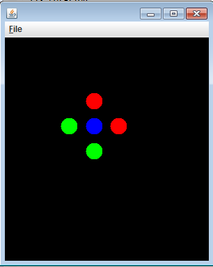

Re: particle simulation using fast multiple method
Post by happyjack27 »
screenshot attached.
not the most exciting, but a sturdy foundation.
file options currently are: open, save, exit.
i fixed scaling - i just had to put it _after_ the parallex projection, because the parallax from scaling on the z axis canceled out the scaling on the x and y axis. and rotation actually works and always worked - it was just the parrallax at extreme closeup causing a fish-eye effect that make it look messed-up.
i think next thing i'm going to do is get the user interface part of the sliders up, and test particle sinks and sources.
by the way, i'm thinking i might be able to re-purpose the engine for a game. :)

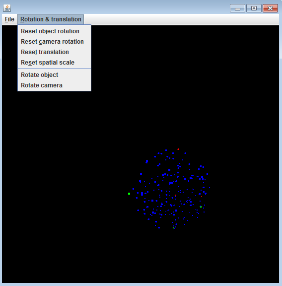

* added rotation & translation menu. also means was able to test camera rotation, translatio, and object rotation together. works fine.
* some multi-threading fixes. i forgot java threads are one-time use, had to switch to an "ExecutorService". also collections were throwing concurrency exceptions, fixed that too.
* tested particle sources. worked perfect out-of-the-box, (except for the multi-threading issue, above) (the blue particles are the ones generated from the particle source)
* wasn't able to test sinks, because it doesn't look like the particle-particle interactions are working, that or they are too weak to be noticeable -- in any case the particles aren't moving or are moving too slowly to validate. i will have to add some debugging output to get a closer look.
* changed the zooming logic to zoom to the next zoom level if the last zoom improved the accuracy by over a certain threshold (currently 0.1%, for testing purposes), or the particle being interacted with is within the current box ("octet"). part of the beauty of this method is it mimics what really happens in the processor due to the fact that the data is ultimately finite-precision. e.g. when you add two floating point numbers, with a 10 bit mantissa, one of them 2^10 larger than the other one, the smaller number will have absolutely no effect on the result, since none of its digits reach the minimum level of significance. this is equivalent to setting the "threshold" to 2^(-10). So the "threshold" is essentially how many digits you particle positions and velocities will be accurate to; i.e. the precision.
