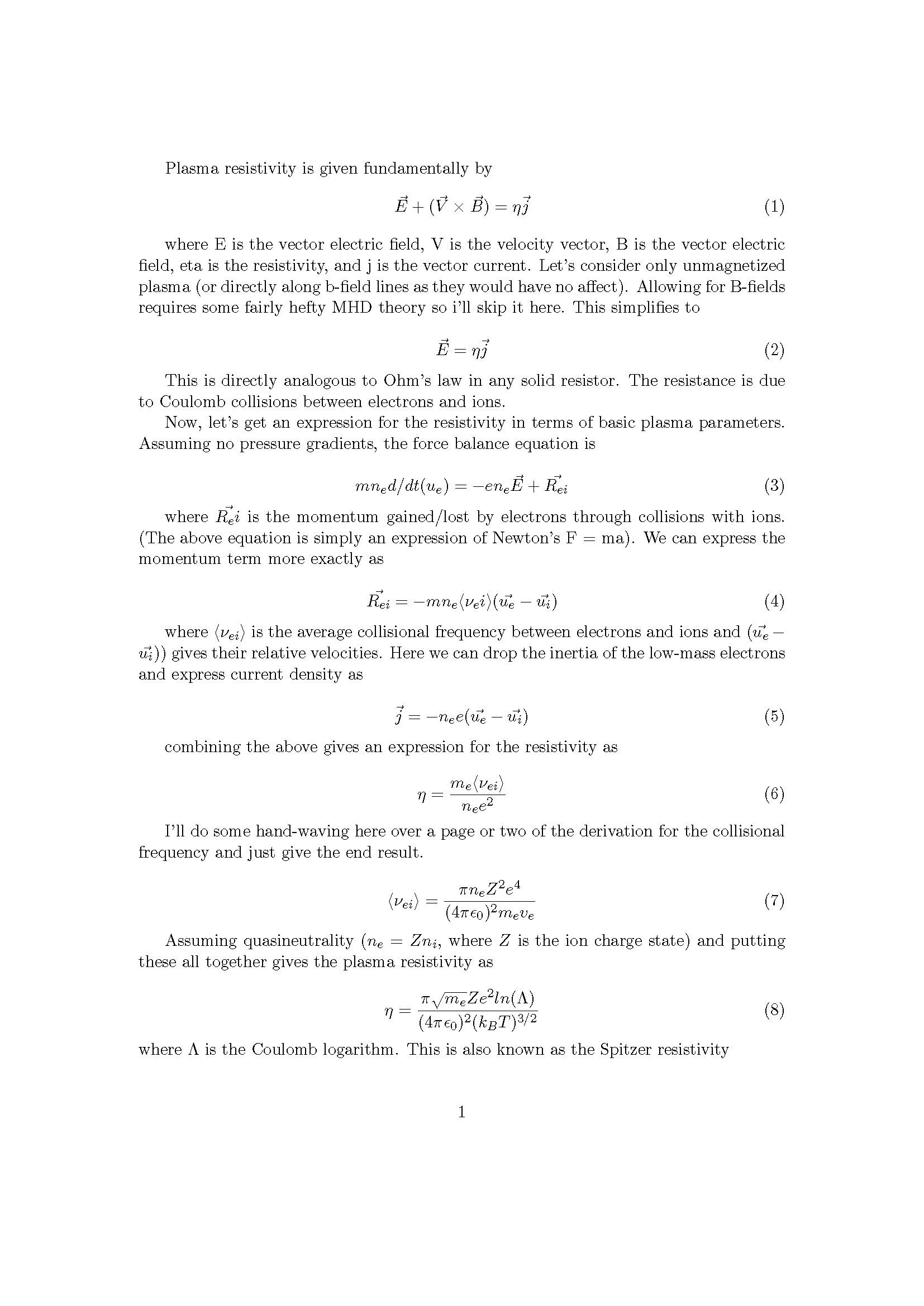

EDIT: apparently this forum doesn't parse latex, see attached for compiled version
Plasma resistivity is given fundamentally by
where E is the vector electric field, V is the velocity vector, B is the vector electric field, eta is the resistivity, and j is the vector current. Let's consider only unmagnetized plasma (or directly along b-field lines as they would have no affect). Allowing for B-fields requires some fairly hefty MHD theory so i'll skip it here. This simplifies to
This is directly analogous to Ohm's law in any solid resistor. The resistance is due to Coulomb collisions between electrons and ions.
Now, let's get an expression for the resistivity in terms of basic plasma parameters. Assuming no pressure gradients, the force balance equation is
where \vec{R_ei} is the momentum gained/lost by electrons through collisions with ions. (The above equation is simply an expression of Newton's F = ma). We can express the momentum term more exactly as
where \langle \nu_ei \rangle is the average collisional frequency between electrons and ions and (u_e-u_i) gives their relative velocities. Here we can drop the inertia of the low-mass electrons and express current density as
combining the above gives an expression for the resistivity as
I'll do some hand-waving here over a page or two of the derivation for the collisional frequency and just give the end result.
Assuming quasineutrality (n_e = Z*n_i, where Z is the ion charge state) and putting these all together gives the plasma resistivity as
where \Lambda is the Coulomb logarithm This is also known as the Spitzer resistivity
Code: Select all
\vec{E} + \vec{V} X \vec{B}= \eta*\vec{j}Code: Select all
\vec{E}= \eta*\vec{j}Now, let's get an expression for the resistivity in terms of basic plasma parameters. Assuming no pressure gradients, the force balance equation is
Code: Select all
m*n_e*d/dt(u_e) = -e*n_e\vec{E} + \vec{R_ei}Code: Select all
\vec{R_ei} = -m*n_e \langle \nu_ei \rangle * (u_e-u_i)Code: Select all
\vec{j} = -n_e*e(u_e-u_i)Code: Select all
\eta = \frac{m_e * \langle \nu_ei \rangle}{n_e*e^2}Code: Select all
\langle \nu_ei \rangle = \frac{\pi*n_e*Z^2*e^4}{(4*\pi*\epsilon_0)^2*m_e*v_e}Code: Select all
\eta = \frac{\pi * m_e^{0.5} * Z * e^2 * ln(\Lambda)} {(4*\pi*\epsilon_0)^2 * (k_B*T)^{3/2}}- Attachments
- untitled-3.png (64.24 KiB) Viewed 16656 times

Ok thanks for showing me the Spitzer resistivity. It's exactly what I needed. I'm going to try to run a 1-d simulation based on that.
