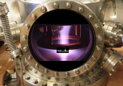

tannerhorne

Re: 1st Superconducting High-beta Device
Way cool! Wait, I guess "way cool" would be liquid helium. But pretty darned LN2 cool, anyway, and I'd love to see a Polywell built like that!
