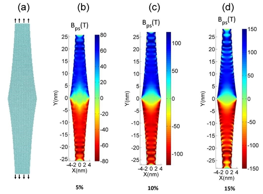

So, if you folded it in the middle, wrapping it a half turn around a nonconducting nanocylinder (with a large enough diameter to keep the two parallel graphene halves from interfering), then pulled on both ends of the cylinder in one direction and the two graphene ends in the opposite direction, the B vectors normal to the graphene would combine, instead of canceling in the far field. Then, form a macroscopic array of many of these units, all aligned in one direction.

- Stretched_Graphene_Pseudomagnetism.jpg (96.14 KiB) Viewed 13357 times

It is not a Magnetic Field, is a Pseudo-Magnetic Field.
It means that the electron clouds of the atoms of the material subjected to the strain process will behave AS IF it was immersed in a strong magnetic field.
Physically speaking, the stretching action in the Graphene changes the LANDAU quantization levels of the material thus increasing it's electron density (and hence changing its electronic properties). Because the same happens also when we immerse a material in a strong and uniform magnetic field than we can actually study the electronic properties of that material at magnetic fields levels that we can't reach yet.
Extremely interesting phenomena for researching Graphene properties, but no real Magnetic Field is generated.

So, electrons behaving AS IF immersed in a strong magnetic field will move generally in circles, giving rise to an actual magnetic field.Giorgio wrote:It means that the electron clouds of the atoms of the material subjected to the strain process will behave AS IF it was immersed in a strong magnetic field.

I concede that the actual field would likely be lower in magnitude than the imposed pseudomagnetic field. Sort of like the losses expected in an electric motor or generator, but with nano/quantum/lattice complications.
It would be interesting to know the conversion efficiency, strain energy vs. B field energy.

It is zero value in the far field, for an unfolded device.Giorgio wrote:a zero value REAL B Field

So this statement is wrong? The pseudomagnetic field does not curve electron paths, leading to a real magnetic field?Giorgio wrote:It means that the electron clouds of the atoms of the material subjected to the strain process will behave AS IF it was immersed in a strong magnetic field.
Re: 200 tesla (localized) by stretching graphene
The statement is right. You are interpreting it wrong or you are not getting the "AS IF" part.DeltaV wrote:So this statement is wrong? The pseudomagnetic field does not curve electron paths, leading to a real magnetic field?Giorgio wrote:It means that the electron clouds of the atoms of the material subjected to the strain process will behave AS IF it was immersed in a strong magnetic field.
You can have same behavior (or deformation) in a material from different causes (or forces). But just because the end result is the same it does not mean that the cause that generated it is the same nor that it will give rise to the same secondary effects (like the creation of a Magnetic Field).
As I pointed out in a previous post, there are already classes of materials that react to a strain process by generating a magnetic field and vice-versa. They are called Magnetostrictive material and are mainly used as transducers.
The discovery of a new class of Magnetostrictive materials based on Graphene would be a huge discovery.
This is not the case, unfortunately.
Strain process in Graphene simply create a local deformations AS IF it was immersed in a strong magnetic field but without any measurement of a real Magnetic Field. Hence the name Pseudo-Magnetic, or Fake magnetic, or Virtual magnetic, but anyhow not real.
Do your "local deformations" affect electrons? Yes or No? You can't have it both ways (except in the quantum realm, and I'm a classical guy).Giorgio wrote:Strain process in Graphene simply create a local deformations AS IF it was immersed in a strong magnetic field
If the answer is Yes, then are electron paths affected (curved) by the pseudomagnetism?
If the answer to that is Yes, then do the curving electrons produce actual magnetic flux lines (whether or not said flux cancels in the far field)?
In the device pictured above, any induced actual flux would cancel in the far field and be undetectable without nano probes.Giorgio wrote:but without any measurement of a real Magnetic Field. Hence the name Pseudo-Magnetic, or Fake magnetic, or Virtual magnetic, but anyhow not real.
Hence my folding scheme.
Which could be futile if electron angular (orbital) momentum conservation imposes a (pseudo)magnetic sign change in one half of the folded device. But that would change odd symmetry to even symmetry, so maybe instead the pseudomagnetism would go to zero as the device is folded and the strain energy would just manifest as a temperature increase instead of as B field potential energy. But that extra heat would radiate away as infrared photons...

It is well known that a strong, real, magnetic field will curve electron paths. If the pseudomagnetic field, up to hundreds of pseudo-Tesla, does not curve electron paths, then calling it pseudomagnetic seems mendacious.Giorgio wrote:Every deformation effects electrons, but this does not mean that every effect on the electrons generate a measurable magnetic effect
Whether or not pseudo B actually induces local, real B, one should expect to measure zero real B in the far field for the unfolded device.Giorgio wrote:Once you focus the point that there is no real magnetic field involved than all the other points you mentioned can't exist.
Saying, however, that there is no local real B because nothing is measured in the far field is disingenuous.
If by "stranding" you mean "stretching", are you saying that someone has measured the local field with a nano probe, inside the effective span of the expected odd-symmetrical cancellation?Giorgio wrote:Once again, if a real and measurable magnetic effect was generated from stranding of Graphene, it would have been a huge discovery with immediate practical applications that the researchers would have pointed out straight away.
My guess is that any B field measurement only looked at the far field.
