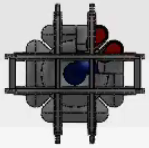

Polywell Fusion Electrostatic Fusion in a Magnetic Cusp - Jaeyoung Park, EMC2
There are nice pictures of the Polywells built by EMC2 in the talk The future goals are stated as:

"Conical" magrid coils on p.22. Lower losses at the non-point cusps...
(Can anyone locate the assembly video?)
