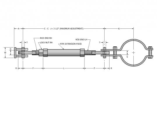

This is what the entire strut assembly looks like. As you can see, there are several bolts that connect the individual parts. The bolts and the parts not connected to the booster wall (anything right of "A"), should be easily replaced. Not sure about the part "A" directly attached to the booster. That one might be welded to it, but I am not sure.

Skip, thanks for the strut drawing. Bolts in the original news conference were mentioned by Musk but his statement was unclear if any bolts failed the performance testing. At some point the strut assembly has to attach to the wall where the wall attachment would be considered part of the LOX tank wall and irreplaceable. If that comes into doubt, it would seem to me that all bets would be off on a September return to launch.
