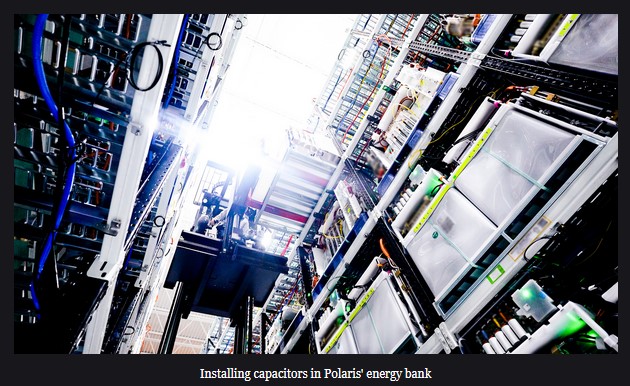

Iterating on early learnings from Polaris
I’ve always believed the best insights come when you’re designing, building, and operating in parallel. One area we’re focused on right now is optimizing capacitor bank connections. Taking early learnings from Polaris, we’re identifying new opportunities to improve connection integration across future systems. We’re developing and testing hardware that could significantly reduce cable count and also designing pre-assembled components to minimize line loss and streamline integration timelines.
Deploying at scale is directly enabled by the R&D that moves us forward. We’re looking for a Director of Research and Development to keep us on pace!
Scaling capacitor manufacturing
New equipment is showing up in Everett every day. We’re building out new test bays almost weekly, running multiple assembly lines and production stations, and calibrating systems that will meaningfully expand our production capacity. I’m especially excited about the progress in capacitor manufacturing. We’ve brought a new winding machine online that replaces multiple steps from our previous process, and we’ve built a new capacitor filling station that enables us to fill up to 20 units with dielectric (canola oil) in a single batch. Each upgrade reduces complexity, increases production yield, and pushes us closer to true gigafactory-scale throughput.
