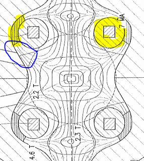

newb question here,
anyone know how i can go about generating a diagram like this (preferably dynamic so we can adjust the currents etc) similar to the one posted here
viewtopic.php?f=10&t=4516&start=45#p101828
based off of their patent diagrams? are there simulation packages that the community has found useful?

Someone mentioned earlier 4 line cusps - I count just 2 circular line cusps parallel to the rings between the central and outer coils. Where are the others?

RERT wrote:Someone mentioned earlier 4 line cusps - I count just 2 circular line cusps parallel to the rings between the central and outer coils. Where are the others?
Oh god someone answer my questions....
So the diagram looks like this:
X X X O X O X X X
O O O X O X O O O
Yes?
Look at the region of
X O X O X
O X O X O
X 1 O 2 X 3 O 4 X
O 1 X 2 O 3 X 4 O
That's four line cusps.
Throwing my life away for this whole Fusion mess.
Re: Aviation Week on the Lockheed Skunkworks CFR
Robthebob, your diagrams don't match the skunkworks design presented. I see it more as
Code: Select all
  0   0   0
0   x   x   0
  w   w   w
x   0   0   x
  x   x   x
w = magnetic well
x = current into the page
0 = current out of the page
cusps I see:
point cusps between adjacent wells and between outer wells and the outside. 4 total.
One way to look at the configuration is sticking a couple extra coils inside a magnetic mirror to create a magnetic well in the center.
line cusps from center well, around inside magnets, to the outer wells. 2. I expect major losses through these cusps to be collisions with support structure.
Post by fahdad »
looking thru their patent application and there really is a ton of details that are either truly there to confuse any reader or they are farther out than they are letting us know and they are comfortable putting out the details.
what stands out to me is the two distinct material they have marked (highlighted yellow)
one is the surrounding of the internal coils. and my question is did LM thru their long history some how have a material that can provide proper shielding here?
The other is the stuff that attaches the internal coils to the blanket, and if it has any local impact to the field lines
btw is there reason they are calling out outside shield dimensions and material so precisely(not by academic standards, of course :) )? is there anything novel here or just patent speak?
" In some embodiments, inner shield 720 is surrounded by layer 730. Layer 730 may be made of lithium (e.g., lithium-6) and may have thickness 735 of approximately 5 mm. Layer 730 may be surrounded by outer shield 740. Outer shield 740 may be made of FLiBe and may have thickness 745 of approximately 30 cm. In some embodiments, outer shield may be conformal to magnetic fields within enclosure 120 in order to reduce losses. For example, outer shield 740 may form a toxoid, "
