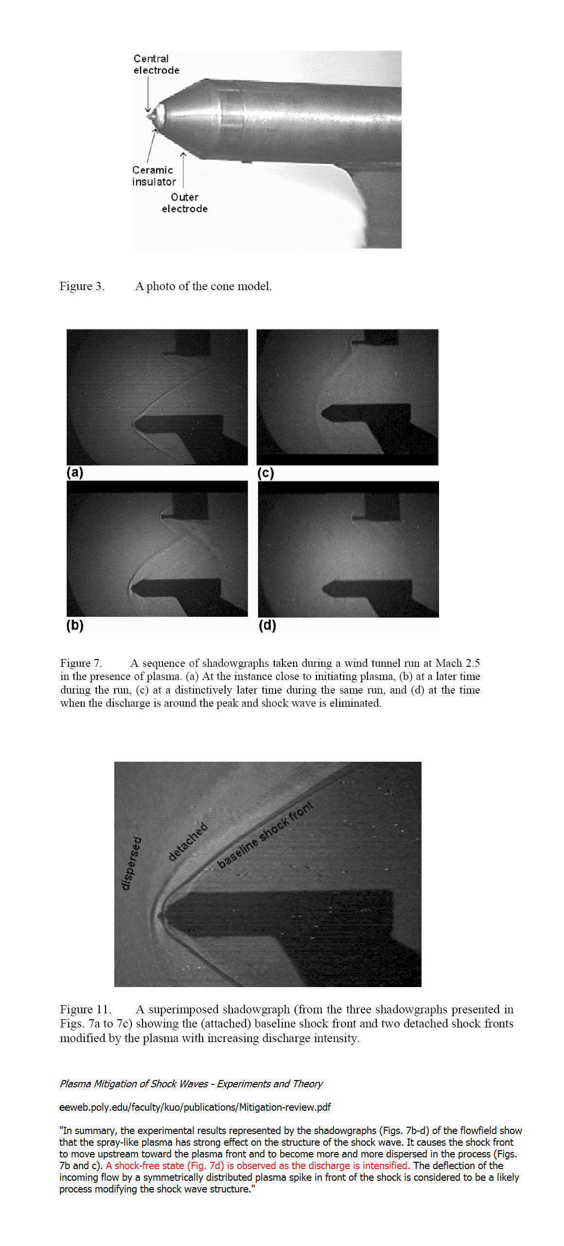

Perhaps an array of these was used:Tom Ligon wrote:A supersonic dash by an object a meter or two high near the pad is ruled out by the lack of a sonic boom on the audio recording. It would be much louder than a rifle shot. I don't think the microphone could miss it, and it would be distinctive.DeltaV wrote: Soooo, that rules out the fan as a propulsor during dash, right?
- Shock_Free_at_M2.5.jpg (242.22 KiB) Viewed 19531 times
