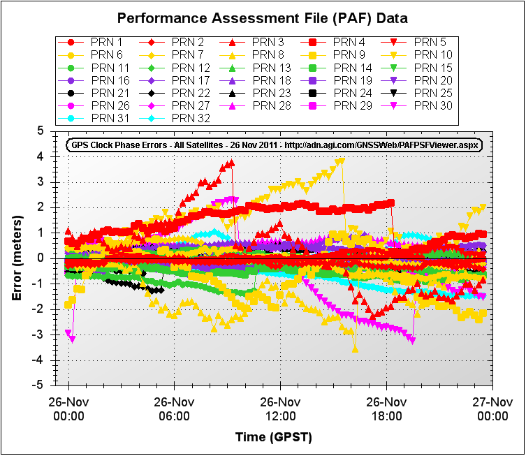

ScottL wrote:If there is no difference in time rate, barring delay in signal from orbit to earth,
There is an actual difference in onboard and ground station time rates due to different gravitational potential. I think everyone agrees on that point.
ScottL wrote:why do GPS satellites need to resync periodically?
Engineers who actually worked on GPS state that relativity is not the reason for these resyncs (emphasis added below):
Long-Term Prediction of GPS Accuracy: Understanding the Fundamentals

Signal-In-Space Range Error
The SIS ranging error consists of two primary pieces,
ephemeris error and clock error. The ephemeris errors are
errors between the actual GPS satellite position and the
satellite position broadcast to receivers. The clock error is
similar – it’s the difference between the actual clock
phase and the clock phase that’s calculated from
parameters sent to the receiver. These errors are typically
a few meters but can be much more, especially in the case
of the clock. Ephemeris errors result from unmodeled
perturbations on the satellite and are reduced to almost
zero when a new navigation upload is made to the
satellite. At this point, the age of data (AOD) is zero and
the broadcast ephemeris is at its most accurate. As time
progresses throughout the day, imperfections in the
ephemeris prediction slowly appear, leading to larger
ephemeris errors.
The clock errors act similarly. The clock errors arise from
quantum mechanical fluctuations in the atomic clock
itself, leading the clock phase to exhibit a random walk
behavior. This effect is difficult to predict and over days,
and over weeks and months would be impossible to
determine.
In this analysis, the job of having to predict the ephemeris
and clock errors is made simpler by the fact that these
errors are clamped. The 2nd Space Operations Squadron
(2SOPs) watches both the ephemeris and clock residuals
in near real time and ensures that they stay below certain
thresholds by uploading new navigation data predictions
to the satellites. Typical satellites are uploaded once per
day; some more often (usually the older satellites), some
less often. This clamping effect on the SIS errors makes
predicting long term behavior easier, in that we do not
need to be able to predict random clock behaviors for
weeks at a time.
GPS AND RELATIVITY: AN ENGINEERING OVERVIEW
Henry F. Fliegel and Raymond S. DiEsposti
GPS Joint Program Offlce
The Aerospace Corporation
El Segundo, California 09245, USA
The Operational Control System (OCS) of the Global Positioning System (GPS) does not include the rigorous transformations between coordinate systems that Einstein's general theory of relativity would seem to require - transformations to and from the individual space vehicles(SVs), the Monitor Stations (MSs), and the users on the surface of the rotating earth, and the geocentric Earth Centered Inertial System (ECI) in which the SV orbits are calculated. There is a very good reason for the omission: the effects of relativity, where they are different from the effects predicted by classical mechanics and electromagnetic theory, are too small to matter - less than one centimeter, for users on or near the earth.
Eminent scientists have been divided amongst themselves, wondering whether the OCS software does not need to be rewritten, expecially since the Department of Defense is now requiring that the current specifications - 6 meters in User Range Error (URE) - are to be tightened under the Accuracy Improvement Initiative (AII). In this paper, we compare the predictions of relativity to those of intuitive, classical, Newtonian physics; we show how large or small the differences are, and how and for what applications those difference are large enough to make it necessary to correct the formulas of classical physics.
As we have shown, introducing the γ factor makes a change of only 2 or 3 millimeters to the classical result. In short, there are no "missing relativity terms." They cancel out.
While certainly not a formal relativity experiment, one could interpret this as early signs of the crumbling of the "Twin Paradox" edifice.
ephemeris errors.
determine.
weeks at a time.
DeltaV, I am sure you could interpret anything in this way, and equally sure that on the internet you will find fuel.
The first quote shows that the corrections considered here are orbit periodic. Not systematic. The twins paradox relativity correction is inserted before the satellites are flown, by setting the clocks to a different rate from earth time.
This one-off rate correction has two components:
gravitational & SR. It is precise.
If it were wrong periodic errors would build up.
Of course the GPS clocks can be resynchronised with earth time, since the continually exchange signals and have known orbits. Your quote your does not say how often this happens.

He states that clock instability makes 1ns/day variation in GPS time.

Are the error estimates above reasonable? In which case they prove that eiter SR time dilation is correct, to within the given tolerance, or else some other combo SR/GR new theory makes a substantial correction to what is currently understood?
Tom
The clock errors arise from quantum mechanical fluctuations in the atomic clock itself, leading the clock phase to exhibit a random walk behavior.
Get the picture?
The diagram does not show which birds are which types and how long they have been on orbit.. That also affects the stability of the clocks. Some of the birds are also in more eccentric orbits, which also induces a higher error accumulation rate.
Also note that long term error correction verses short term are an important difference. The graph you have shown is short term error, The GR (46us) /SR (7us) corrective factors are long term. Without them the entire chart is depicted would skew over time as the rate error accumulated.
I do understand your point, but I think that you miss the part about the long term correction. Some birds in fact are more stable over the longer run and track well within the daily limits (200ns if I recall) and do not require the short term adjusts. Those would be the ones tracking down the center of the axis. There are birds that go long periods without corrections, and they tend to be the ones in the most stable least eccentric orbits with newer clocks. Although, I believe there is an older bird that was orbit adjusted, and has behaved very nicely for a number of years since that.
edit: corrected SR/GR units to usec vice nsec.

It is 7us/day, not 7ns/day for SR correction.
That is 2100m/day correction.
DeltaV - I sometimes think that you just don't pay attention to numbers.
Your picture, which I get better than you it seems, shows max 10m/day typical 1m/day.
How can all those clock errors be significant?
Sorry Tom, my typo. I did mean usec.
I am curious about decay rates. I did some searching, but still nothing definitive on SR effects on isotope decay rates.
Are you certain that the SR correction hasn't, by this time, random-walked away from its "factory offset" value?
