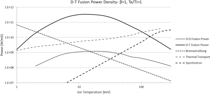

True as far as it goes, but here are a couple other factors to consider. For one, the power relationship between fuels does seem to change with both beta and Te/Ti, as well as temperatures. Note that D-He3 power peaks at higher temps than D-T.
Fuel ion heating by fusion products is the other factor that makes me hesitant to assume D-T vastly outpowers D-He3, at least at all machine temps (post-compression, pre-fusion). Since most of the D-T energy is in neutrons we might see less ion heating from D-T (a sort of "wet match" if you will) and consequently lower final plasma temps and lower power.
So for instance we might find that D-He3 is so efficient at self-heating that the average ion temps in a 12KeV FRC spike up to (say) 70KeV after fusion, but for D-T at 12keV machine power self-heating only pushes ion temps up to (say) 15kEV. I don't know that this is the case, but it might help explain why Helion is so optimistic about D-He3 -- Kirtley's paper calls out the need to remove energy from fusion products quickly before they can heat electrons.
One important note, in an ignited D–T (or D–He-3) plasma, particle heating primarily heats electrons (regardless of initial heating method), leading to the typically large electron to ion temperature ratios, and significantly increased radiation losses, further emphasizing the desire to remove energy directly from the fusion products prior to ignition or significant electron heating.
Of course, this is all handwaving, and it probably doesn't particularly matter, but it's fun to think through.

Also, there is this last graph you shared (my understanding is it comes from simulations by Helion). The situation it depicts, even with Te/Ti=1, is one where Qsci>10. If we add the supposition that Te/Ti would be more like 0.1 (not unreasonable, following the previous reasoning), then all those losses would be lower, resulting on an even higher Qsci.
Lastly, regarding electron heating. Remember that, even if by percentage it is much less burning D-T than burning D-He3, absolute power on charged particles is much higher in the former (20+ times more). This will increase losses, no doubt, but will also favor ignition (theoretically not needed in Helion's machines, anyway).

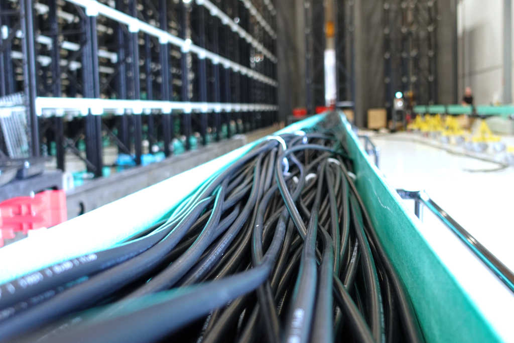

Cable trays are moving in
When we built Trenta, we spent more time hooking up cables than on anything else. For most of the machine, each was installed on a capacitor, dragged into place, then installed on the machine. Anyone who was at Helion for the Trenta cable install will attest to how long and tedious the process was. We’ve learned from it.
We’re now doing cable connections with modular cable tray units that can be assembled out of the racks, hundreds installed all at once, and quickly attached at each end. Over the past couple months, we’ve made major progress on tray fabrication and installation. We have no illusions about how time-consuming cable installation will still be, but we’re seeing that our new system is much faster, cleaner, and better than what we did on Trenta.
