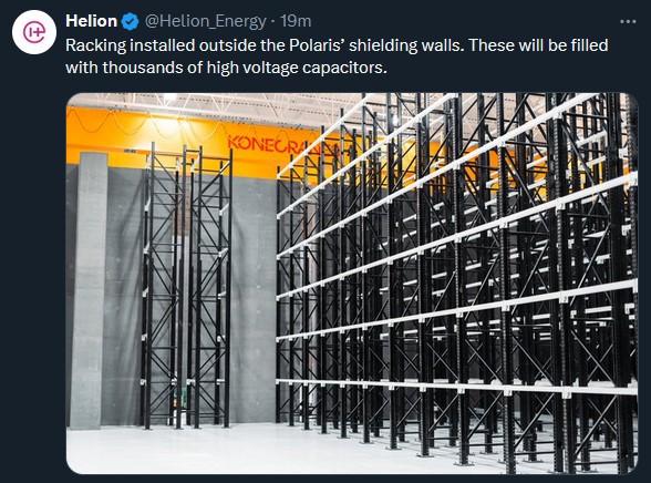

Slow news lately, but here is a bit from Helion about their upcoming capacitor installation at Ursa:
