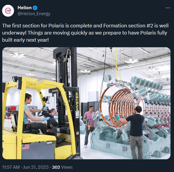

First section of Polaris is complete and the second formation section is well under way.

Posts: 2188
Beautiful machine!
