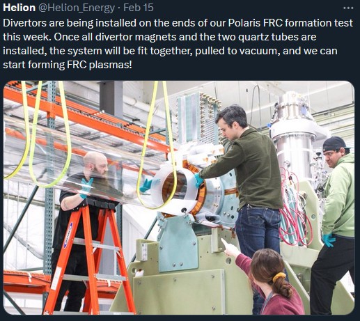

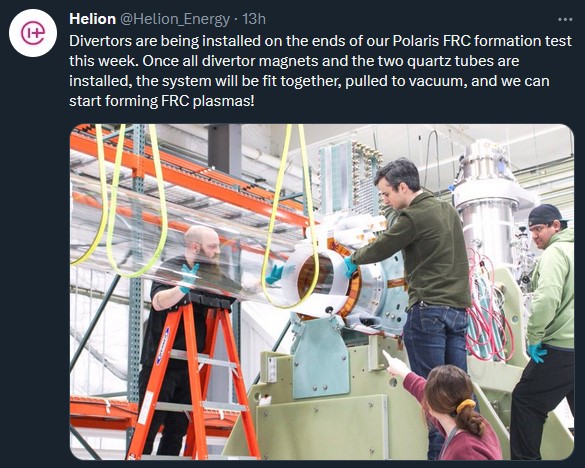

Divertor added to Polaris Formation Test Section:
Divertors are being installed on the ends of our Polaris FRC formation test this week. Once all divertor magnets and the two quartz tubes are installed, the system will be fit together, pulled to vacuum, and we can start forming FRC plasmas!
https://twitter.com/Helion_Energy/statu ... 30656?s=20

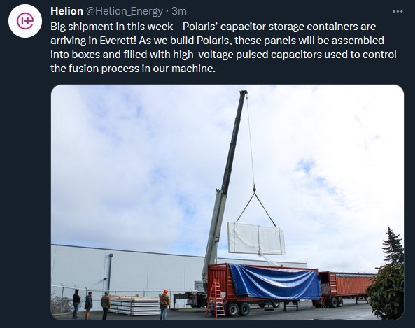

Helion capacitor storage has arrived and Polaris formation test article:
