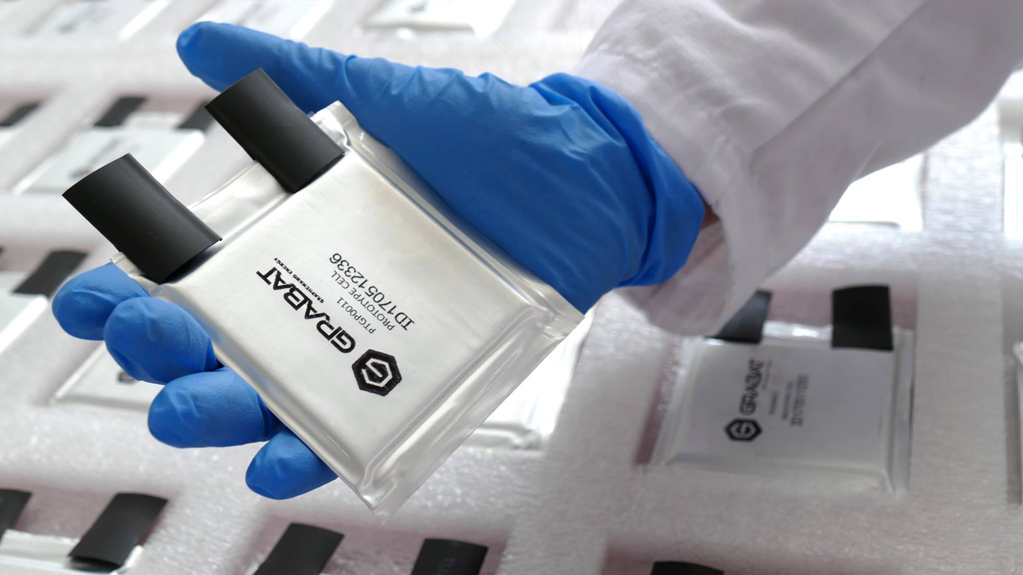

Re: Graphene battery announced
Sorry for the necrothreading, but Grabat just posted this image (and several others similar to this) on their Facebook page. No more information was given and we don't know actual performance values of this "production"(?) model of their battery. Nevertheless, after a year of delays that made me think that this is complete vapor ware, this is a bit of a surprise. I would still recommend to remain skeptical and cautious. Who knows what the actual performance of these things is?
