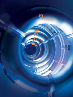

I count 5 coils. Numbering 1-5 as nearest-farthest, coil 3 (center coil) appears to have the largest diameter.
Ignoring the two end coils, this looks like an "inverse" of Torulf's "synthetic" FRC:
- Lockheed_CompactFusionReactor_5Coils.png (123.92 KiB) Viewed 84830 times

At firs,t the image did remind me of that- with end cap magnets to decrease axial plasma losses. The selinoid with end caps has been described in the past. The major difference is the central focus issue and the B fields that are not always convex towards the plasma.swamijake wrote:Isn't that just a magnetic mirror? I don't get it.
But looking closer, the central three magnets do look like what I have described as a Polywell derivative. The second and forth magnets are the equivalent of an old mirror machine with an aspect ratio of ~ 1 (width equals separation). But the central (3rd magnet) placed between splits the single intolerable leakage equatorial line cusp into two much more narrow line cusps. This substantially reduces and possibly greatly reduces the total line cusp losses. The Polywell does the same thing with a different geometry. The line cusp losses are greatly reduced with the important preservation of the internal reaction volume. You could also decrease the equatorial line cusp loss in a mirror machine by moving the magnets closer together, but this also shrinks the corresponding internal reaction volume.
Also, this setup allows for a central focus like the Polywell, along with the favorable convex field lines towards the plasma, and open spaces between the magnets that allows for electron recirculation. The truncated cube Polywell has two line cusps that are deformed and compressed to the extent that referring to them as corner point like cusps has been used. It also has 6 face centered point cusps. This design has the two line cusps that are compressed but not deformed and two point cusps. The line cusps may average greater width than the Polywell, but the reduced number of point cusps may make up for most of this. Also, the reaction volume is less spherical, but still quasi-spherical as I understand it.
I have been considering this three ring arrangement for ~ 3 years and have done some permanent magnet experiments in this configuration. This has given me insight into the gross magnitude of line cusp narrowing possible without the critical shrinking of the internal volume. I think the central magnet having a greater diameter is beneficial for several reasons. One key to appreciating the design is to remember that the magnets have real dimensions . Bussard, etel made the mistake of assigning mathematical lines to the magnets which changed ExB diffusion perspective and also the effective separation of the magnets. With mathematical lines the separation is straight forward. But, with different minor radius dimensions assigned to the magnets things change. All that is important is the strength of the B field at the surface of the magnet cans. as this changes the effective separation of the magnets for cusp descriptive purposes. EG: two magnets with a separation of 1 meter as measured from the center of each magnet minor radius (can radius). If the cans are 10 cm in minor radius, the seperation is only 80 cm from can surface to can surface. This surface is where the B field starts falling off in the essentially vacuum medium. The internal can fields are irrelevant from this perspective. Therefor the advantage of having a central ring magnet is greater than simple mathematical calculations with assumed linear magnet dimensions would suggest. Having the thicker center magnet magnifies this if circular dimensions are assumed. Having elongated oval shape along the cylinder axis of the machine would help more. How much deviation from circular can be tolerated is an open question. Thus the greater minor diameter of the central magnet and resutant greater major radius. Also, having the central magnet greater in diameter changes the geometry of the two line cusps. Instead of pointing out laterally, they are canted towards the ends. This may allow for a smaller diameter vacuum vessel and have advantages for placement of conversion grids, plasma out flow guiding grids (think rocket thrust), etc.
The two end magnets are somewhat confounding as they do not contribute to a central focus, but perhaps their contribution to restricting/ controlling the point cusp losses are advantageous.
The greatest distinction between this and the Polywell design may be how the issue of electron/ plasma injection through the available cusps is handled.
The comment about operating past Beta =1 is confusing. With cusps, the best confinement is at Beta=1, or infinitely close to it. Past Beta=1 or Beta>1, the cusp losses increase. I speculate that other issues may compensate for this though. The "Wiffleball" surface may be even more 'sharp'. And the total reaction volume may be a little larger, so operating slightly past Beta= 1 may be the optimal compromise. Recirculation and electron injection issues may also contribute to the best knob setting...
The D-T choice of fuel seems pessimistic, but perhaps this conservative approach (like Dr Parks comments for the Polywell) are the best political position as the Fusion community has a familiarity and acceptance of this approach.

Indeed.DeltaV wrote:I count 5 coils. Numbering 1-5 as nearest-farthest, coil 3 (center coil) appears to have the largest diameter.
